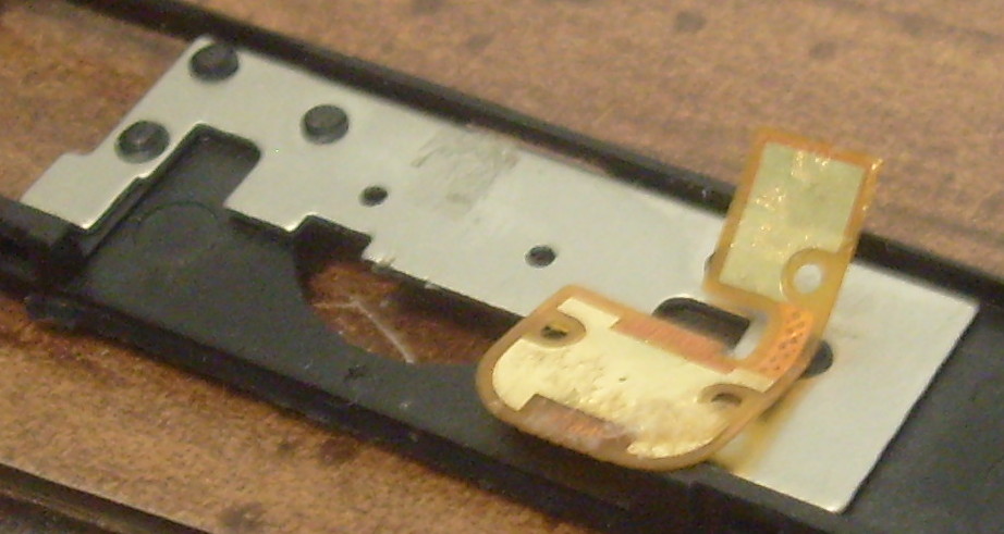

OK, doing some diag work on the iPod, here is what I come up with:
Shorting the Z shaped contact (under the home button location) to the frame makes the home button work so that part is OK.
I can't seem to get the small circuit under the home button to work, I checked the old 'midframe' with the attached metal bracket and found the adhesive for the home button circuit seems to be a sparkly metallic stuff, likely conductive. I used standard plastic adhesive left over from a midframe. Therein lies the problem.
I now need:
Conductive adhesive (or somehow remove the old original stuff and reuse it!)
Some way to remove all traces of the plastic adhesive before I apply the conductive adhesive so it will conduct electricity.
Why does no one who sells midframes or screens even so much as mention this!?!
Backside of midframe with underside of home button circuit shown. See the nasty little spots of glue on each?!? Still want work.
Not as discouraged.
Apple products work!
