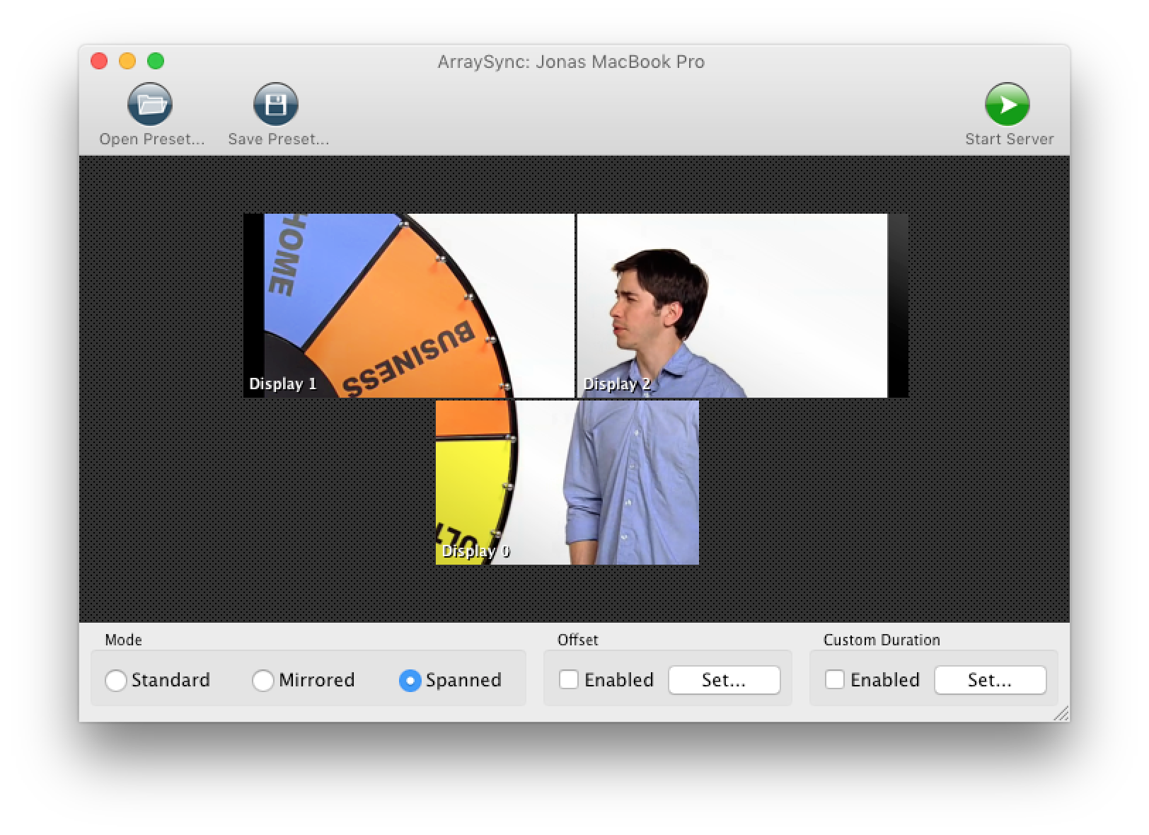

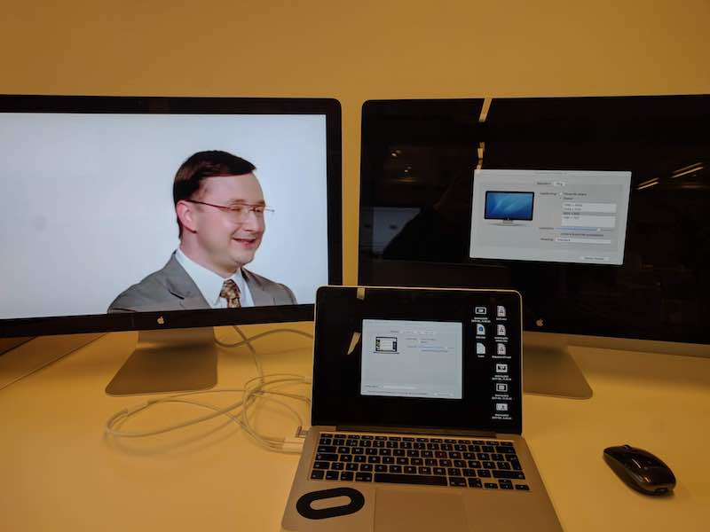

Hi, trying to use ArraySync for a small exhibition setup, seems to be the perfect tool for my setup. However, I am running in to trouble immediately. When starting the server (using two external Thunderbolt displays plugged into my MBPr) the video only shows up on one of the external screens, nothing happens on the internal or second external screen (actually, the 'status bar' on the top of the screens disappear). Same result no matter settings: standard, mirrored or spanned. What might be the problem?
Note: it seems to be only the display namned 'display 1' that shows the video. Also, see attache images for what the setup looks like (everything seems fine to me), and how it shows up.
