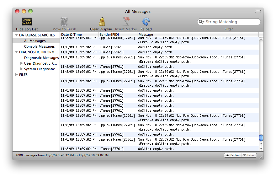

Re: My iTunes won't open!
Try this. Make sure iTunes isn't running. Launch Console from the Applications/Utilities folder. In the window that appears, select "All Messages" from the panel on the left.
Now launch iTunes. After it fails to launch, go back to Console and see what's printed there. Perhaps copy and paste it here so we can all have a look.

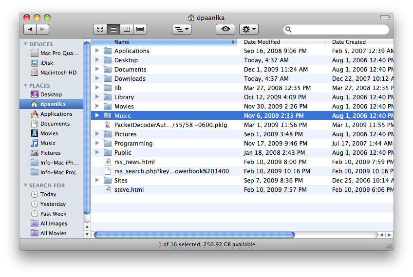

My biggest worry is losing stuff I need. How do I backup my itunes library. I am a worship pastor at a church and I can't lose my music. So how do I back all of that up? And then how do I reinstall
jnewman wrote:My biggest worry is losing stuff I need. How do I backup my itunes library. I am a worship pastor at a church and I can't lose my music. So how do I back all of that up? And then how do I reinstall
Simply go to your user folder by clicking the house in a Finder window or by going to the Go menu and choosing Home. The folder that says "Music" - just drag that to an external hard drive. That's pretty much it. After you're done reinstalling, you'll replace the *new* Music folder with your backup.
