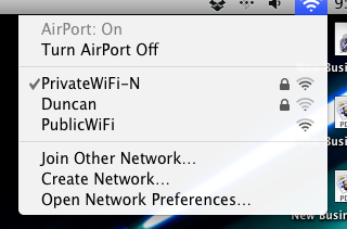

Well I followed Apple's instructions exactly and it did work as far as the Macs are concerned - there is only one network visible to Macs. Only PCs see "PrivateWiFi-N 2".
And for the Macs this one network now has more bars where before it only had one or two.
I used the "extend network" not the WDS stuff.
