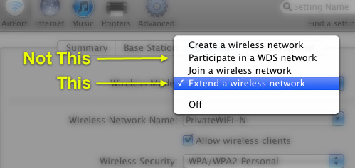

I enabled "Allow this network to be extended" on the Extreme, and put the Express into "Extend a wireless network" mode and configured it as necessary. I must have done it right because now all my Macs see the original network (named PrivateWiFi-N) as before, but now receive the signal more powerfully, and the Express shows a green status light. So far so good...

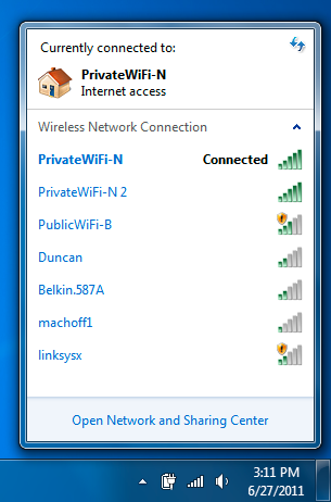

However, on my brand new Windows 7 laptop (the only Windows machine I have), it only sees a network with SSID of PrivateWiFi-N 2, not the original (without the "2"). Attempting to connect to this 2 network results in failure. But by manually setting up a wireless network connection, and typing in the correct SSID, my Windows 7 laptop successfully connects to it.

Any help appreciated. Picture attached below.
Extending AirPort - two networks visible to PCs?

Well I followed Apple's instructions exactly and it did work as far as the Macs are concerned - there is only one network visible to Macs. Only PCs see "PrivateWiFi-N 2".
And for the Macs this one network now has more bars where before it only had one or two.
I used the "extend network" not the WDS stuff.

Sorry, I misunderstood.
That's. Weird.
You've probably already tried resetting both stations, clicking "Allow Extended" for the primary and "Extend a wireless network" for the secondary, so the only other thing I can think of is to try again using the Windows version of Airport Utility.
